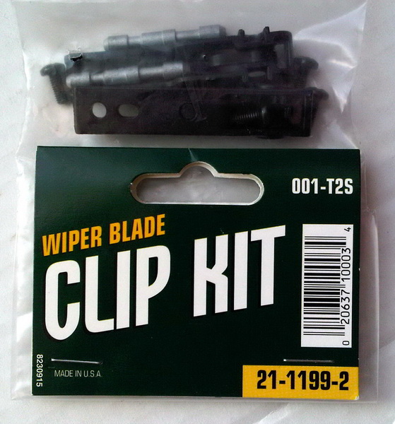

I ended up buying a little adaptor kit for about $9 at Canadian Tire (after one blade fell apart in the ass end of nowhere up on Vancouver Island), and drilled a single hole in it to accept standard NA-style blades, incl. the 26" ones.
Tony.

Update - FWIW I found the packaging for that part:
"Wiper Blade Clip Kit" Part # 21-1199-2, UPC code # 0-20637-10003-4
Remove the old clip, drill a single hole in the new adaptor to line up with the second hole on the Delica stalk, insert a standard side-pin-retaining wiper blade, and voila!
I secure it down with a tie-wrap too, just because I'm paranoid (on a previous vehicle I had a wiper blade come unclipped under the stress of heavy snow going down the #1 Hwy at night. Not fun.)

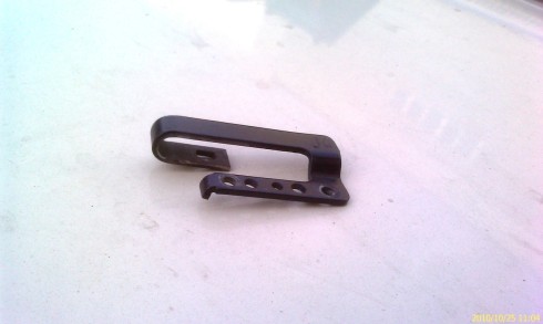

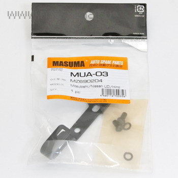

If you happen to visit Russia you can buy Masuma adapters specifically for a Delica. $1.60 (US) each.
Masuma wipers adapter

Hey Tony, I bought that part from CT but it didn't fit as the arms on my Van are 3/8 wide whereas these adapters are approx 5/16". Has my van got non-standard arms? Would like to hear from others.
I also e-mailed these guys ...
http://www.masuma.com/catalogue.php
...asking about the Matsumo part pictured in above post. I'll let you all know what sort of reply I get.

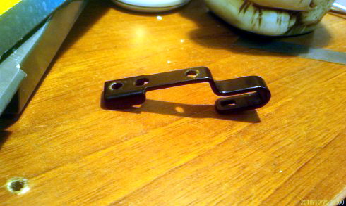

Serigy, the ones in 1st pic are exactly what I bought at C/T but the channel is too narrow for my arms (I'll be returning). But where did you find that other one; the last photo? That's exactly the type I'm looking for.

These pictures were taken from the same thread on delicaclub.ru. My goal was to expose the other Delica owners experience. Sorry, I have no idea where to get these adapters; Russians have tons of local OEM and aftermarket parts sources for any vehicle from any part of the world.
