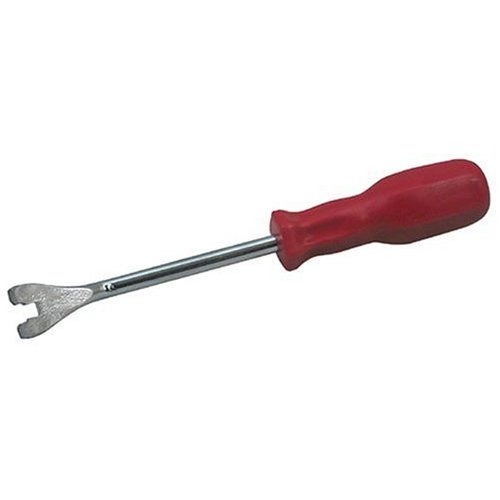

The best way to remove the plastic holders is with a large flat screwdriver with a V carved in the blade. This will allow the blade to force the plug up on both sides. If you do break any youcan get more at lordco.
Re: Removing Sliding door Interior Trim (Scary)
You need to use one of these:
Door Upholstery Remover
Door Upholstery Remover.jpg (11.28 KiB) Viewed 8228 times
It's easier than grinding a notch out of a really big screwdriver.

its not so much the clips will break but more they will pull out of the panel and stay in the door, if water has been near the interior panel it'll do this to you, I got some 8mm custom wood and made new ones up, even reused the old material on the door (although luckily for me it is factory vinyl).

Princess auto sells panel/upholstery removal kits for like $10. You get a handful of tools, all basically for prying but in different shapes, for this kind of job. They are made of a sturdy plastic and work quite well compared to my previous makeshift tool. Key is that you can grab the plastic clip and pry that without tearing the panel.
