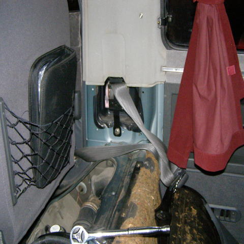

Right behind you ...... really.
In the b piller..... behind the pastic wall trim between the drivers door and the side window.

Is it above the seat belt attatch point on this piller?

Correct. You have to remove the seat belt retaining assembly to get access to it. :M

That's where the glow plug relays are, but the ECU is behind the driver seat belt.

Found It!!
Thanks everyone.
Took me a few moments to get it out as one of the bolts is located in the aircleaner bay....
I took apart a little more then I needed too!!, LOL.
