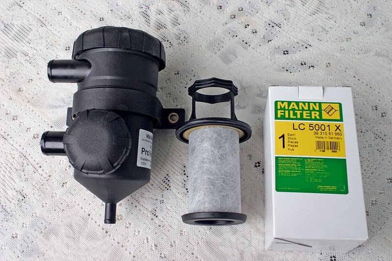

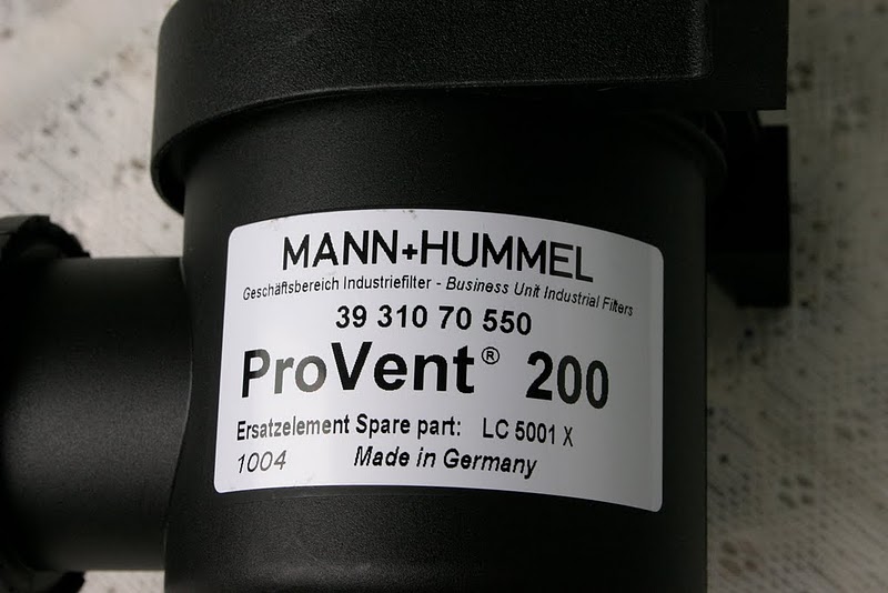

I think this topic did not have enough coverage, so I dare to post this. The friend of mine installed a German made Provent oil catch can on his Pajero to keep an intake manifold, an intercooler and a turbo clean. I got one to install it on my L400 when it arrives. Here are some pictures to give you an idea what I am talking about.
- IMG_9868.JPG (141.84 KiB) Viewed 13789 times
- IMG_9869.JPG (69.41 KiB) Viewed 13787 times
- This is how it looks installed on Pajero.

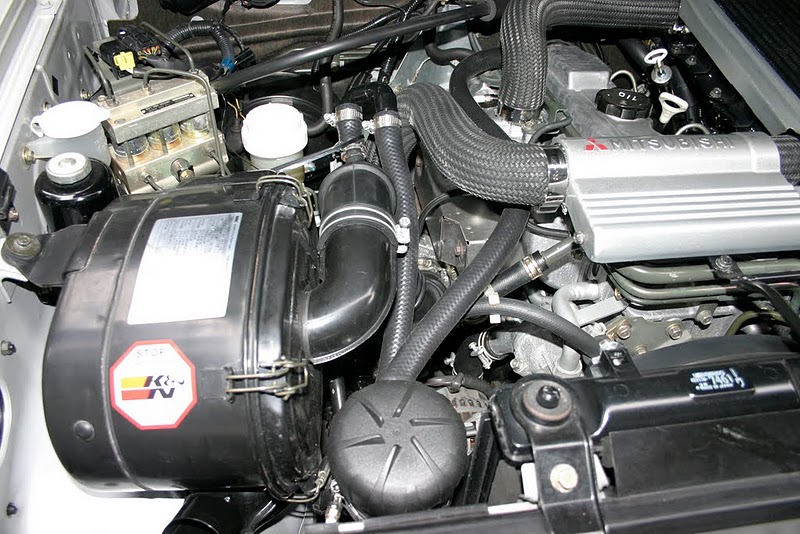

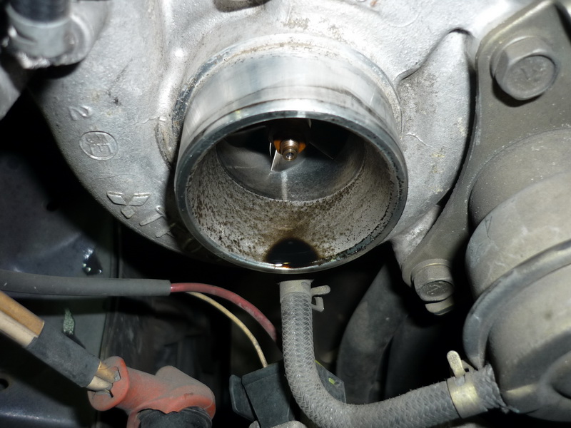

Finally I put my hands on my new ride and the Provent oil catch can is in along with some other goodies. The first picture illustrates the reason for this modification and the second one shows how a Provent looks installed:
- P1020398_resize.JPG (171.58 KiB) Viewed 12413 times
- P1020426_resize.JPG (232.69 KiB) Viewed 12648 times
