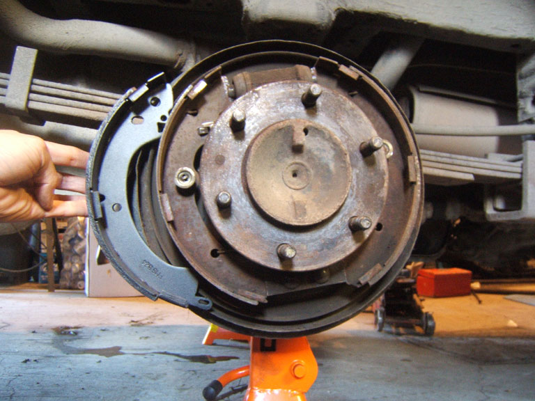

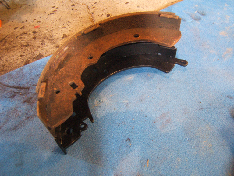

But the main concern of the day are the rear brake shoes. The FMS 524 that were supposed to fit are a bit different than the ones I have one my 1990' Delica. I tried to check every single shape out of my dealer's catalogue but couldn't find any equivalence. The only two solutions I see for now are:
1- I take the used ones and get them rebuilt with new linen. This is not perfect since I will have to wait a few days vefore getting them back (and I need the van almost every day) and that won't help next time I will change them again.
2- I do some modifications on the new shoes I got from the dealer. This not perfect since some of the holes I need to do are too close to the edge if I don't want to affect the integrity of shoes.
If someone have a better idea...or had a similar problem with their shoes, I will be glad to hear from you.
If the parts dealers in BC have the exact same ones, I don't mind getting them from there.

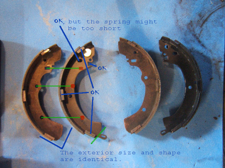

Assuming you got the right shape, you can cut out the notches you need.
I have a set in my shop that need the same thing done to them. If you want to come over and work on them together we can.
I confirmed with a local rebuilder that cutting the notches out is fine.
EDIT: I checked and those you have are identical to mine. I got them for some $35 at DV Aldous on Fraser.

The brake shoes from DV Aldous that are missing a couple of notches are $40 (ish) and the OEM matching ones from Max OD are $80. From memory, I think I've seen the OEM matching ones for more than $80 at several other suppliers. I know for a fact that the imperfect ones from Lordco are more like $90.
So you can either spend half an hour with a drill press and a file modifying the aftermarket shoes to include the tabs that the Delica has or you can spend $40-50 from a number of suppliers around town. I think that for many people its worth the $40.
Now, DV Aldous (who supply a popular importer we all know, btw) has told me flat out that if I bring them an OEM set they will sort out the matching problem for me. So that's another thread I haven't closed yet. With my Delica up on the stands in the shop, only a few blocks away from DV Aldous, I will be following up on this soon.

Thanks for the offer, I'd be glad to work with you, but I feel the 3 1/2 day drive to Burnaby is not worth the economy :-) I believe I'll do the mod on the 524 I have got here. I'll try to post pictures for further references if anyone wants to follow the same path.

@jaggedfish: you are right. It is certainly not worth the 40 or 50$ saving. I was more taking it as a challenge to push further my own limits at Macgyvering things !!
For what I think, brake shoes action and its efficiency relies on its ability to transfert the cylinder brake horizontal forces on both sides of the shoes. The top AND the bottom of the shoes actively participate in this action. The original brake shoes and the 524's share the same shape at these specific points of contact.
The missing holes in the aftermarket shoes are there to keep the parts at the right place and bring back to 'neutral' position after braking. They are not supporting any active pressure and modifications should not be altering their efficiency nor integrity
But anyway, as I said, you are right, and it seems 40$ bucks is not worth the try. But if I ever get stuck in South America with rear brake deficiency, I'll have a clue of a how-to-get-out-of-shit-do-it-yourself solution :-D
