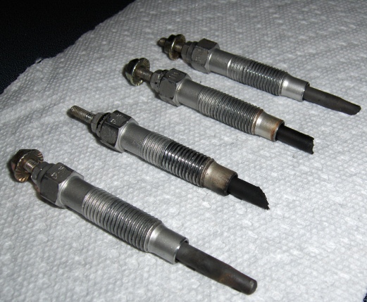

I have put little bits of info in other posts about what has turned out to be a engine right off.... small recap first.
short version: just over a month ago on the highway, not under load.......... big puff of smoke (mostly white) and sounded/felt like I lost a cylinder and pretty much all signs of a head gasket or cracked head. Off the road and stopped immediately, no leaks, all fluids looked good, no bubbles/smells and all that good stuff.
Head came off about a week ago, sorry no pics..... but the number two piston and head insert all marred up, cylinder wall scraped and the lip of the precombustion chamber broken off. Number 3 precombustion chamber lip is cracked and looks like it would break off soon. As noted in another post, the glow plug can never hit the piston, there is a pre-combustion chamber where the tip is located.
UNLESS :mrgreen: a tip breaks off or something like what happened to mine.
glow plugs are, left to right, 1,2,3,4 ...... these were installed new about 1.5 months before the incident.
Speculation at this point....... the number 2 and 3 have obviously lost their tips, possibly overheating? number 4 looks like it is starting to burn up or became damaged and number one looks as good as new.
Why, some would overheat and other one not overheat is beyond me, common ground common power all cleaned up nicely.
In the end, I have a new (used) engine going in next week...... $12500 for my Delica, $1200 to replace coolant system, $5500 "ish" for blown engine, getting main seals and such done while the engine is out. expecting about another $1000 at least to fix up a bad lift and get aligned. $1000 in misc, oil catch, cold air couple other toys..... expensive toy.
Comments/thoughts/conerns?

Some more research and thought............ this did happen around/after end summer temperature dip...... searching out, could be a fault of glow plug circuit and or temperature sensor...... short version, plugs on too long during the after glow period (after start up)...... think I might rig up a circuit to max out the after glow cycle to <1 min.

What make are the plugs?
From my 1.6L VW days I found all plugs not to be equal.
I would use a tester to see how long the plugs cycle for.
I would add a light to the dash that lights when the plugs cycle and maybe a disconnect switch (you could use a wireless security battery disconnect like the one that Canadian Tire sales or boat/racing car battery disconnect switch (lots of amps)). Or you should be able to remove input power to the controller to shut them down.
I have thought about since I often forget to roll the power windows when I park and end up with the plugs running at the same time as I am trying to roll the windows. When I wired my Mercedes Diesel powered Jeep I could turn off the glow plugs. Handy.

thedjjack wrote:I would add a light to the dash that lights when the plugs cycle and maybe a disconnect switch (you could use a wireless security battery disconnect like the one that Canadian Tire sales or boat/racing car battery disconnect switch (lots of amps)). Or you should be able to remove input power to the controller to shut them down.
x2
already in works......... fancy(heavy amp) stuff not necessary, just need to interrupt the control voltage at the relay, not the heavy amp side directly to the glow plugs. Just putting a little led in a switch panel I am making for below my single din deck in dash.
If I have time, want to put several makes of plugs in old head and burn them up, time them and check temps..... IF i have time
Would end the glow plug debate quality once and for all :-)

thedjjack wrote:Sorry to hear.
And could you check on the side of the plugs near the widest point (outisde of the actual head); it might have a voltage rating stamped on them.
I think they make plugs for 6V, 11-12V, and 24V supply voltages; if yours are 6V plugs, they will be way too low resistance and run way too hot. Vice-versa for 24V, so not likely to be the case.

tonydca wrote:it might have a voltage rating stamped on them.
11V - these are plugs that I installed at the beginning of August....... due to the lengthy afterglow period post start, I would be surprised if 6V rated plugs would last much past a week.
