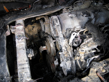

That was it for me with Delicas, at least for the time being. Yesterday night I used the block heater for the first time this winter, plugged it in at midnight, and at quarter past 1 the van was in flames. It's completely done. Will see if ICBC will cover this (I do have comprehensive), but I guess all said and done I won't be able to afford another Delica. Had quite a bit of uninsured contents (my tenant's insurance ran out two weeks ago!!) I'll have to replace, and everything I've heard and read about ICBC and Delicas points to me not getting half the car's worth :-(
So, unless a miracle happens, I'm saying good bye to you guys for the time being - thanks so much for all the help with glowplugs, etc.!! If you do have inputs about claims and value and ICBC, I'm happy to hear about it. Will read some of the old posts, but currently am not too optimistic.
*very very sad and upset*
I might post a picture... it's quite impressive how much damage a block heater can do!!

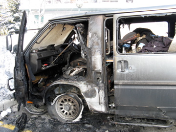

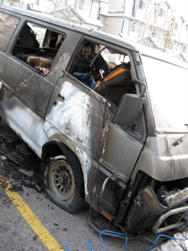

for the voyeurs amongst you.. apparently the flames went metres high. didn't see them myself, though, blissfully asleep.

looks like an over achievement with the block heater!

I could not understand how a block heater cause a fire in just over an hour. Did you have a fuel or leak?
Looks like your van was parked outside. Is it possible someone tampered with the wiring or deliberately torched it? Just a thought and something to look into.
Good luck with your claim! Cheers.
Re: Good bye... Van on fire.
The only way I can see a block heater causing an electrical fire (these are diesels, they won't burn like gasoline vehicles) is if the cord/wire had a cut or an exposed section that touched the frame somewhere. That would cause an arc like a welder and start burning very fast.
I haven't heard of a properly installed/maintained block heater causing an electrical fire ever.
I've seen some Delica's with block heaters that were not installed properly = cord only.
The cord should have a protective sheath over it, usually aluminum tape/foil to keep the heat away and shield it. At least from the block to the fender.
