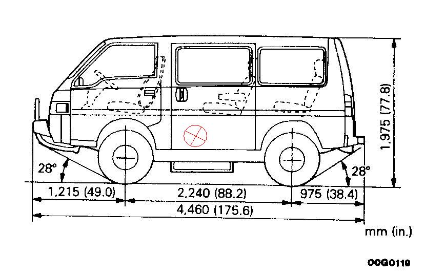

Have you corrected your torsion bars? With age the torsion bars sag, letting down the front end of the vehicle and should be cranked back up again. The general stock weight displacement between the axles is 60/40 (front to back) which is not really what I would call "front heavy". In fact the general centre of balance is located just behind the sliding door handle and just above the axles. This is so for cargo hauling purposes ~ they're pretty much 3/4 tonne wagons.
Delica Elevation.jpg (72.3 KiB) Viewed 5298 times
Falco.[/color]
