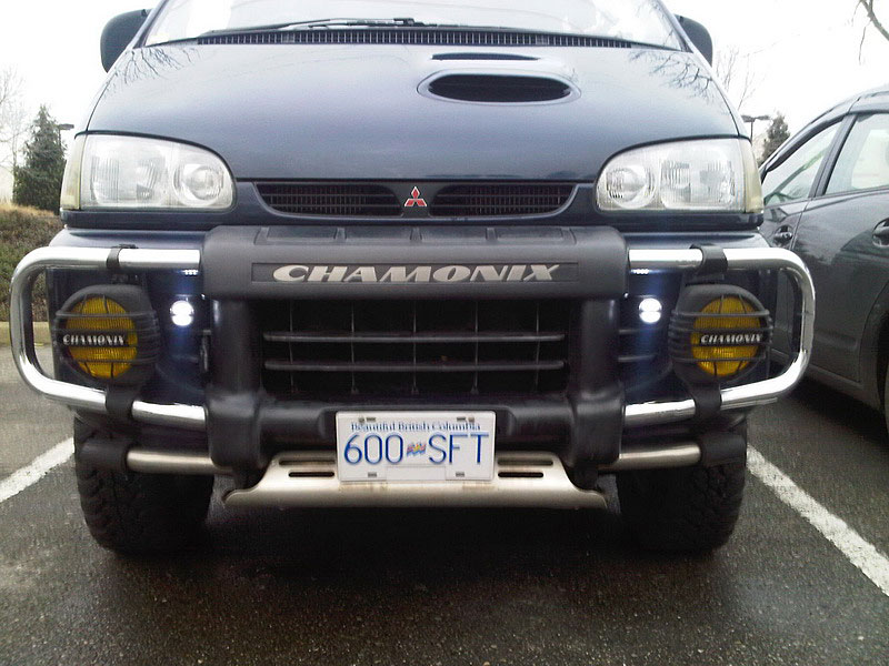

- Profister
- Posts: 963
Re: Headlight blues
Like this?jfarsang wrote:I found it better in the long run to use a pair of dot small lights for your daytime running lights spliced into a power wire when the ignition is on so that it's on it's own circuit and won't affect your headlights.
- DRL
- IMG00048-20101216-1529_resize.jpg (108.18 KiB) Viewed 7017 times
