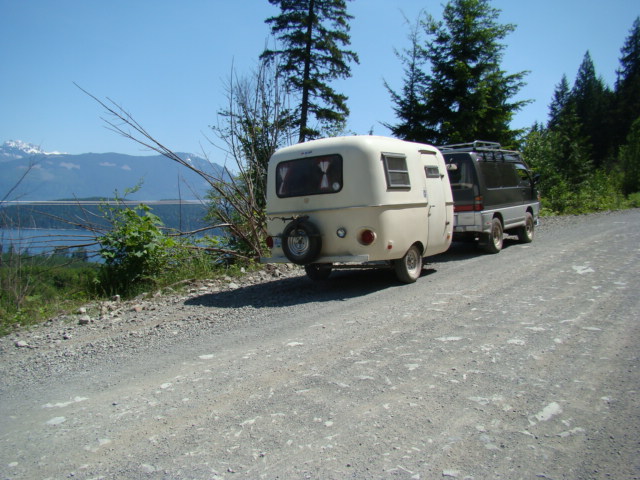

Towing a Boler with a L300 isn't a problem. But you have to pay attention to the engine and transmission temp during the summer months. I guess the 2800cc would be better for towing (in a hurry).
- goinguphill2.JPG (108.08 KiB) Viewed 5079 times
