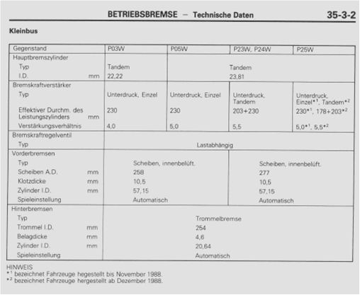

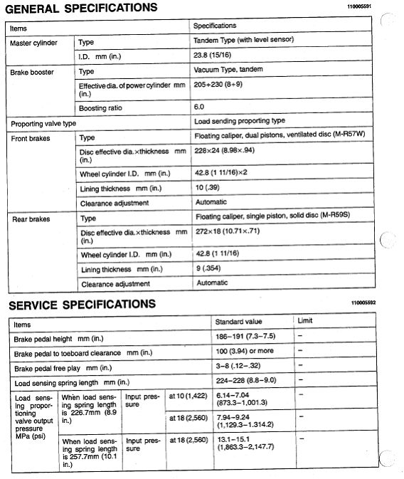

But now I am eager to know: Is it possible to change the Delica's rear drumbrakes to pajero's rear, single piston brakes?
I'm started the exploration on- and off-line too, but i'm not sure right now...
Delica's brakes (P25W):
Pajero's brakes:
