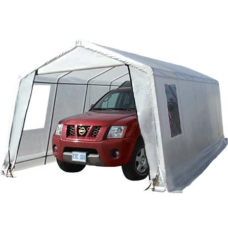

Apart from the block heater, if you have a spot that's YOURS only, you could have a small canopy with sides, you could have a "soft" parking garage, and with a small heater running inside there overnight, at least the temperature would be above zero, eliminating lock freezing problems, ice on windshield and all that stuff.
something sort of like this:
http://www.canadiantire.ca/browse/produ ... 20+x+10-ft.

and i do love the temporary garage idea, but it would get shredded by wind and thrown rocks :)
