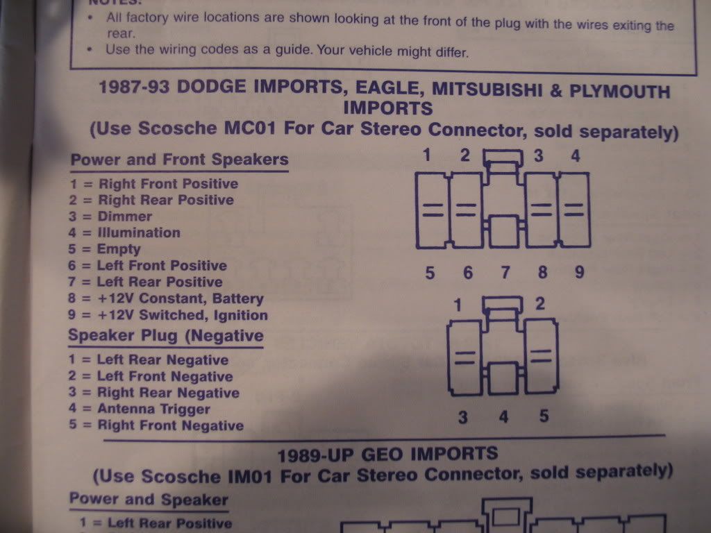

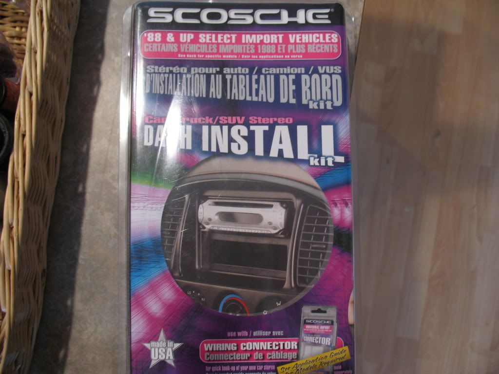

I just did my stereo install night before last (1.5 hrs). Stop by your local Wally-WalMart and pick up a Scosche Kit #UI2225F It's a universal import kit, you'll also need the harness kit but I'm not sure of their stock number, MC01 I think. Future Shop shouldn't have had a problem with the mounting plate, I got my harness kit through them. I know that they don't have Delica's on their system, but the harness kit for the Dodge Colt is the same one so tell them they can search that one. Hope this helps.
Tom
PS
Here's the pin configuration for the harness you'll need (from the install kit instructions)
Here's what the install kit looks like.

AWSOME ITS IN!!! ill take some picutres soon.. thanks for all the help :D
