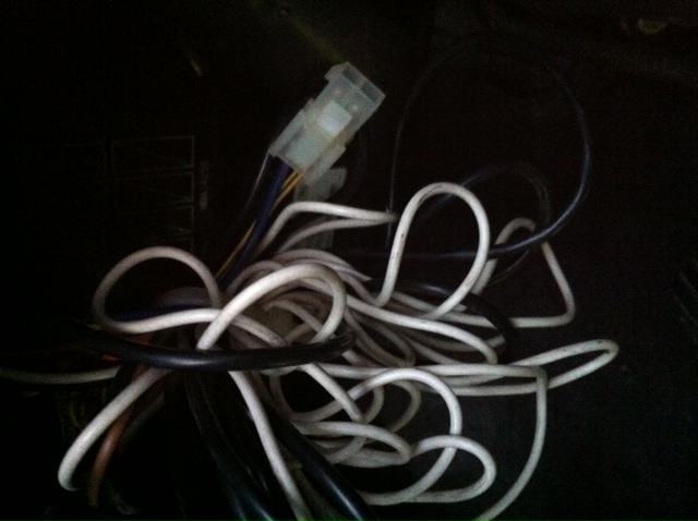

My Deli never came with fog lights so I picked some up. I heard that the '91 Super Exceeds came pre-wired for the addition of fog lights and
there might be some wires coiled up under the dash.[img][/img]

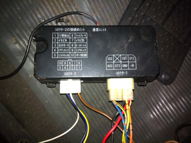

I took a look under the dash and found this black box. Any one have any ideas? I figure it's an Aux Box.

Could I skip these steps with the " Magic Box " ? and either plug into this or use the black and white wires for the fog lights? I'll check them if they have power.

Who knows what this photo is of?
- After pulling I found this box? My Japanese is not that good but maybe it's an auxiliary magic box??

If its under the dash it could have been for an old navi kit in Japan. My old van also came with a glove box full of wiring for one. I'm pretty sure all 91s came with fog lights stock tho

Thanks for the reply. I pulled it out from under the Steering wheel. My '91 Super Exceed doesn't have any fog lights but I'm guessing that one of the wires might be for the fog lights. I'll see if I can translate the writing on the box to english somehow.
I think it's a 20 year old remote starter module. Anyone know where I might find the plug connections for adding fog lights to my '91 Super Exceed?

I think you've found an old alarm system:
1. Door open
2. imobi A (not sure what that means, but probably a shortened version of something like "immobilize")
3. Alternator
4. Door unlock
5. con-light-cancel (not completely sure because of the resolution)
6. foot break
7. imobi B
8. auto-keyless
9. door lock
10. (not sure, too hard to read)

Thanks Tojo for the translation. I thought it might be a remote starter, I've now removed it and have some left over
wire harnesses.

I also checked the wire harness I pulled off the " black box ". A few wires are powered on and off when the Deli is running.
Is it bad idea to run power from these?
