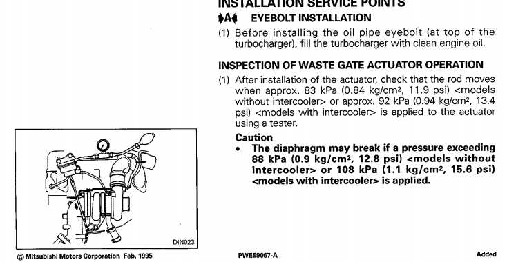

As im reading the manual with specs right now, I can tell you that you're wrong. It says that the wastegate should open at 11,9 PSI on the 4D56T engine.jfarsang wrote:Factory boost is 8-9 psi.
11-12 psi is the max you want to push it in stock format.
- wastegate.PNG (105.49 KiB) Viewed 8302 times
