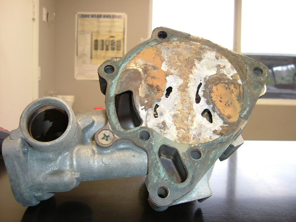

We quote one and a half hours to change out the thermostat . Remove drivers seat and the large metal plate it is mounted on . Then unbolt the power steering pump and swing it out of the way . The lower hose / thermostat housing is now easy to reach . I would strongly recommend changing upper and lower radiator hoses themostat and radiator cap all at the same time . Improves the operation of the cooling system and gives way better heater heat . Water pumps are also a very good investment as its not what they look like from the outside but what is going on inside the engine . I will post a picture here later of a water pump taken out of a van with a no heat complaint . This van had 67,000km on the clock . It had no leaks externally but has suffered the typical japanese lack of maintenance . Moral of the story .... flush the cooling system when the manufacturer says !!!!
[img]
