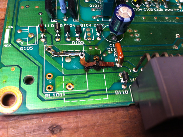

I took out the ECU. It's located in the RHD driver's side B-pillar, behind the seat belt mechanism. Not hard to get out, once you know where it is. Opened it on the bench and a trace to the relay is burned.
Popped the cap off the relay, and it's fine in there. Cleaned the contacts for good measure. Tinned the segment of the trace that had been heated enough to lose its coating, and soldered a 22 gauge wire to bridge the trace that was burned.
