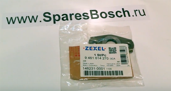

Yikes! That's not pretty.
I don't have a source for you, but it's part number:
BOSCH 9 461 614 270
ZEXEL 146231-0001
Mitsubishi ME741046
I would think a fuel injection shop with a Bosch or Zexel account should be able to order the part for you. Not sure about the russian website in the photo below though.

Domo arigato Rising Sun.
Parts in stock and kindly priced.
