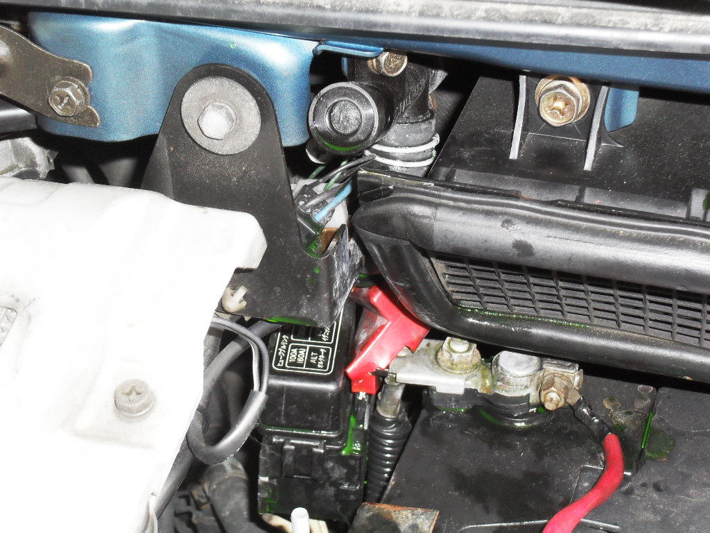

Just noticed this leak
Post by mycale »
Just noticed this today and contacted Marty about it. I am not too sure if it will require a big fix or just a little one. When the engine in warm green fluid is coming out of this tube under pressure...the bolt-head broke off and I am guessing the seal is broken...any ideas on how to do some damage control on this B4 i can take it to someone to fix properly?

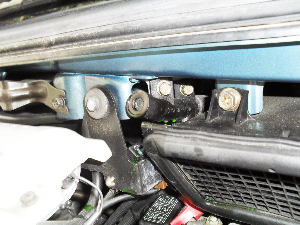

So it turns out the end of the plug for that pipe is just busted off. I managed to pull the threaded part out, but the end "bolt" like end just broke off which means there is no gasket to seal the pipe. Got rolly eyes at Lordco looking for the part, sheer confusion at Crappytire, hoping i can find the part somewhere. Now, what the heck is the name of this leaky pipe? anyone?

I think that port is to bleed any air out of the cooling system as it's at the highest point :M :-D :-D :M

madmazda wrote:I think that port is to bleed any air out of the cooling system as it's at the highest point :M :-D :-D :M
That is exactly right it is an air bleed for the cooling system.
The bolt is plastic and can go brittle and break.Just try and seal the hole up for now until you can get the replacement parts.
Any part or hardware store should stock something for sealing up plastic to get you back on the road as a tempory repair.
Hope this helps

If you can't seal it up, you can replace the whole plastic piece with a 5/8" plastic elbow (90 degrees with barbed ends) you should be able to find one at a hardware store, or an autoparts store. It will just be a little harder bleeding the air out of the coolant system.

or replace the whole thing with a brass with pipe fittings, hose barb ends in 2 ends and a plug on the 3rd, lordco should be able to fix you up with that in about 5 minutes.

Its a very easy fix, I believe the thread is M10 but not 100% on that, you can buy a couple of stainless bolts of different sizes, about 3/4 long buy a rubber gasket or O ring, and you have your fix,
However you can also just get the bleeder valve from a mid 90's subaru as they have the EXACT same fitting, I know because when i brought my van in and had the system flushed the mechanic droped mine and then steped on it, trashing the threads, a subaru car was in the shop at the same time, we looked at it , pulled it off, tried it and it was the perfect match, $2 part from Lordco and all was good, but just think how nice a pretty stainless bolt would look........

Coolio! Thanks all for the advice! I managed to do an bandage repair this evening by taking a cheap rubber floor-mat from crappytire, cutting a portion of it, and using a hose-clamp to seal it on there. Haven't had a chance to test it, but will be doing so on my drive tomorrow to Lordco for a search of the Subaru part mentioned in the last post. On the question of coolant...any ideas what would be the best to use in the vruck? I am also pretty sure i know where to put it too! OMG this is the most I have EVER worked on a vehicle in my whole life! haha it's kinda fun cheers again for all the good advice!!

So the thread size on that part is M12 1.5, so that size is not available! WEEEEE! So, I talked to Carl at Lordco, he found me a bleed valve that is M12 1.25. Went to a nuts and bolt place on Alpha St, and they couldn't source that exact size in stainless! haha painful. I ranted about everything in Canada being measured in metric except for parts and construction materials for about 5 mins alone in the van ;-) Not too sure if i want to force the new part with the different pitch value. I don't want to mess up the thread if Marty can find the exact replacement.
