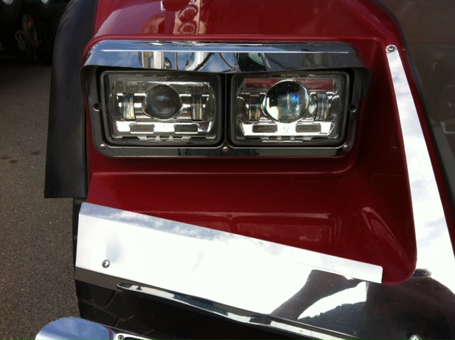

Here is a pic of those LED/HID square headlights on big rigs.
- photo(4).JPG (108.13 KiB) Viewed 5457 times

Im a sucker for lights... really looked into the LED headlights.
I guess one problem with them is they don't generate heat the same.
Some might think that is good but it isn't... heat from lights keeps the
lense from icing up in the winter. LED's tend to produce heat at the
back of the unit, not the front..
I would like a set though to play around with.. but not at $500+ for 2 lights,
then another $500 for the inners... :(
I'll look for a wrecked one :)

x10 on what firesong said.Firesong wrote:Im a sucker for lights... really looked into the LED headlights.
FS
I have a pair of trucklite military LED headlights on my truck and they do not generate enough heat to melt the snow that builds up on them driving down the road. lots of heat coming off the back frm the heat sink but nothing in the front.
