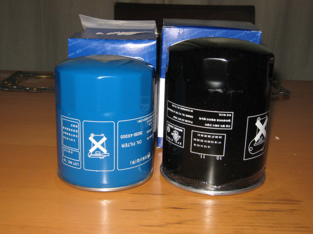

I just love researching deals on the net.... So today I took the part number off the oil filter I've been using. It's: Hyundi 26330 4X000. So I researched that for a while and Came up with this list of supposed cross reference-ing filters. Do y'all think this is possibly correct?
The source is on this page: http://www.js-filter.com/catalogue/filter/28760/C109J

Jedidiahwiebe
- Posts: 113
- Joined: Sat Oct 02, 2010 8:58 am
- Vehicle: Delica L300
Re: L300 4D56 Oil Filter Cross References
Am I just using the wrong filter perchance? Been using it quite a while.

I'm guessing if you have been using them for a while with no leaks and such your ok.
L300. Yep, been quite a while no problems. I did some phone searching for baldwin bd28 filters. Found them for a good price in Kamloops 18/a filter at Peterbuilt, but I think i may have to buy 12. Anyone in the Kamloops/Salmon arm area that wants to go in on a pack?
