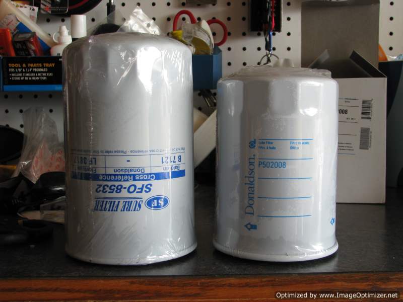

Here is a picture of the difference in size between the Donaldson that is recommended for our vehicles and the Sure Filter that Mardy sells. I bought one just to see the difference.
I have decided that I am just going to stick with the Sure Filters. Cost and performance wise they can't be beat IMHO. So... any of you Paj owners here in Edmonton want to trade me some beer for a Donaldson filter?
