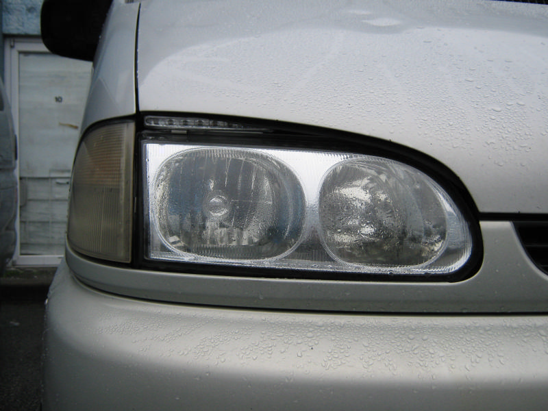

djelica
- Posts: 124
- Joined: Sat Nov 14, 2009 9:49 am
- Vehicle: L400 Super Exceed
Re: L400 Headlight Problems
Hi Big-Bird
Thanks for your reply. Doesn't really matter what's in the van now. Maybe it is just the glass, but the bulb sizes for low beam is not the same as what I am putting in (a first series unit, what it should have).
I just need to know what bulb it uses. I'm confused because all I can find are two filament H4 bulbs (I'm told 12v H4-60/55 are what is used). And this is my confusion: the low and high beam are two separate units and not single high/low unit, so I would think a single filament bulb would be used, but what do I know.
Anyway, I'm going to try the H4-60/55 (for 1st gen L400 low beam), but I'm looking for confirmation if I can find it.
Cheers, Darren
pic below is not mine, but what mine looks like.
Cheers, Darren
- depo headlight example for 1st gen L400 (2).JPG (157.11 KiB) Viewed 6401 times
- Big-Bird
- Posts: 1218
- Vehicle: 96 PE8W Spacegear
- Location: Calgary
Well shoot, thats a first! I always wondered how that would look but was convinced and told this wasn't possible. I have seen the front clip from a Gen 2 swapped onto a Gen 1 L400 its not a common swap. Fenders,hood, bumper are all different between the 2 styles.
Here's what you need for the L400 Headlight Bulbs
1st Gen: H4 (hi-lo) H1 (hi)
2nd Gen: H7 (?hi-lo?) H1 (hi)
The gen 1 delica uses a dual filament H4 in the outer most reflector and your stock plug should have 3 wires for lo-hi beam operation.....unless some genious removed a wire at some point and made it Low Beam only...hope not!
