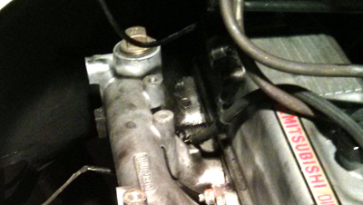

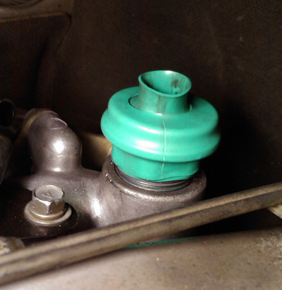

Standard practice is to put a hose clamp around the manifold and over the valve to hold it closed. Flexboi made a fancy adjuster here: http://dinoevo.de/pressure-valve-blocker/ and I've seen heat shrink used:
I cheated and replaced it with a brass plug. Not recommended unless you have a boost gauge and a boost controller.

So in both of these scenarios you don't have the line from the turbo attached anymore. So how do you control the wastegate??
Where exactly is the pressure releasing from out of curiousity, Is it the threads where the valve is screwed in?

Ah. In my picture the engine is half disassembled- it's difficult to get a photo of the pressure relief valve with everything installed. The wastegate actuator is installed as usual, with the usual line going to one of the turbo's output spigots.
I suspect you might be getting the wastegate actuator confused with the pressure relief valve- my apologies if not. Here's a slightly clearer image (ignore the green arrows- I stole this off teh internets):
The actuator is the large can that connects to the turbo. Its job is to manage how much exhaust gas goes through the turbine in order to control how much boost the turbo is making. If it's disconnected the turbo can make unlimited boost, which will damage the turbo and possibly the rest of the engine. Not good. It's set by the factory to control boost to around 8psi, but by messing with it (shortening the control rod, adding washers to lift the can up, or adding a boost controller) you can increase the amount of boost your engine makes.
The pressure relief valve is a backup emergency pressure relief. If your boost is set to the stock 8psi it never opens at all. There's a flat cap on the top- when boost pressure is too high (like if your wastegate actuator was disconnected), it lifts slightly and lets air out. The problem is that it opens at 12psi, which is easily attainable when tuning your engine.

Haha do you live on the forums? Thank you! I actually was confused, the close up pictures with a plastic sock on it confused me for the actuator.
I will investigate a bolt or shrink wrap. Thanks again.
