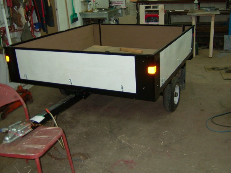

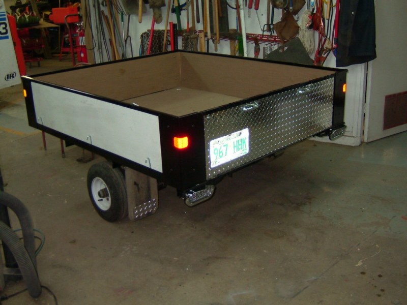

Then after it started to rain went to the garage and was working
on my little trailer. We extended the little thing another 6 " to each
side and the front. Then put all new corners (rounded 1/8" steel)
Gave the silly thing a 6" lift since it was wayyyy too low. I think
it was originally for a small low car. I painted it black (framework)
and then the sides/front are 1/2" treated plywood with white puckboard
on the outer sides and stained on the inside. Looks pretty sweet.
The sides are 14" high. I didn't want a big trailer. The cool thing
is the color scheme is black frame with white sides. Matches
our white/black Delica.
Can't wait to finish it... it's soo close. Even put on cool LED lights
etc. The tail gate is going to be aluminum checker plate on the 3/4
plywood. A little different than white puckboard but I didn't want to
use that there.

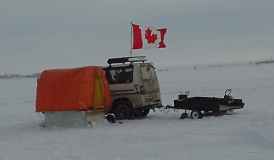

Here's a picture of the new (old) trailer.
Do you think it will go along with the White/black color scheme of the Deli?
I put in a picture of the before.....
FS
FS
- This is the trailer before the updo. :) Whatcha think!?
- trailer.JPG (41.46 KiB) Viewed 1635 times
- trailer2.jpg (76.7 KiB) Viewed 1635 times
- trailer1.jpg (85.06 KiB) Viewed 1636 times
