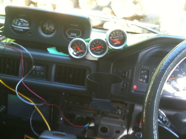

Just finished the most beautiful gauge installation ever.
Maramiesto came over to provide spiritual guidance
and Lordco runs.
Calm cool thoughts ruled the day.
Just had to rewire in a nonscrappy way and it all works fine.

- IMG_0093.jpg (73.42 KiB) Viewed 1770 times

Re: Pyro help
I'm digging it!!! woot!

Re: Pyro help
Looks stock!
