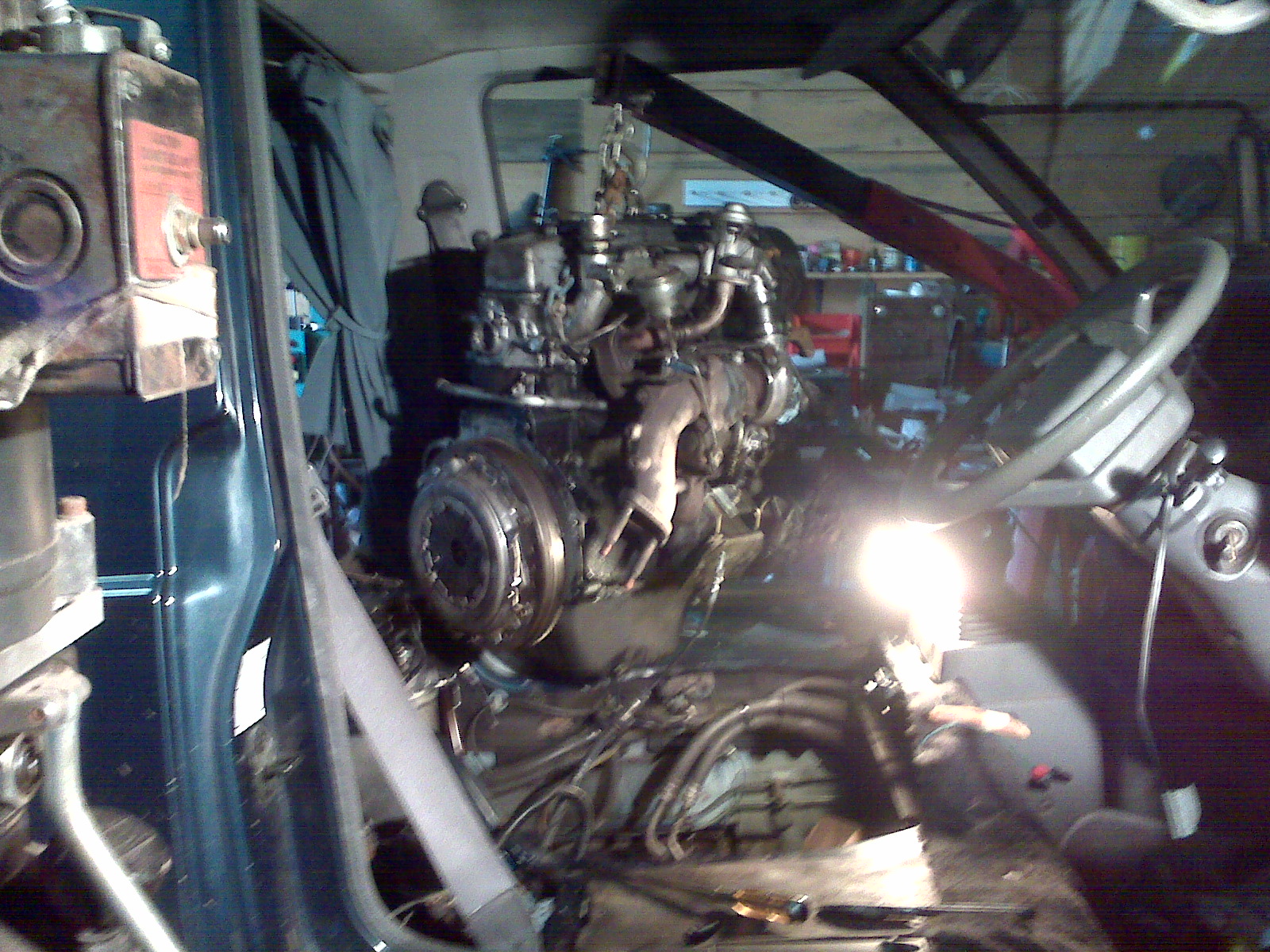

hi there, funny you should ask, i've just finished doing transplant on mine and i'm no mechanic though have done couple simple swaps before.
At first it looks a bit daunting, but once you start, and work methodicaly its pretty straight forward.
1. get everything you need for the swap, the new engine, arm type engine houst, all belts, crank seals if needed, filters, usual tools, flat smooth suface to move the houst around on, lots of cigorettes and a kettle!!!
2. remove seats, drivers seat plate, bonnet, passenger door (door is heavy so houst helps hear) and radiator.
3. intake manifold is different, turbo was still fitted on new engine and was good so i left it on, undo exauhst take off fan, then removed pas pump, and alternator
4. undo and remove the 4 bell housing bolts, plus the 6 bolts atching the flywheel to the torque converter (u have to remove inspection plate to get at theys), the starter motor an few other bolts that hold inspection plate and other bits and bobs on, have a good look around for any wires still attached
5. get houst in position, undo mounting's from the chasis (alot easier than taking them off from the engine)
6. make shaw the engine houst is as low as pos. to the engine when you strap it up so its easyer to get out the door. you'll need a mate to help get the engine out as its a bit of a faff but not to bad.
7. swap the pump, flywheel (if needed), front pully (again if needed), while engine is out, don't do fly and pully though untill you have timed everything up with belts on.
8. put every thing back in again reversing prosess.
Not to bad a job really, took about 5 shortish days, didn't want to rush anything. you get to know alot about a your truck while you at it. any questions about anything just ask and i'll try and answer it best i can remember.
