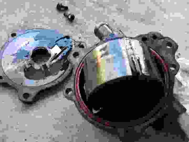

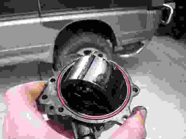

Hey guys my L300 Turbo oil pump is pooched. I phoned around and people were surprised mine failed. The shops all said they would get back to me but no one has one on the spot. (lower mainland) But it is sunny today...
Was down in westport when my Deli started growling at me. Thought it was the alternator bearing but pulled it out and it spun fine (pain in the butt, but thanks forums for helpful tips). took the oil pump out and apart, sure enough metal chips inside. :( The filter in the banjo looks okay, hopefully the turbo is spared.

Some pics, because everyone likes pics.
