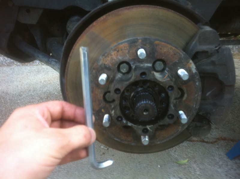

FAILURE :-(
There is one tiny screw attaching the caliper to the rotor and it was stripped! :-x
I came so close but it looks like I will have to give in and take it to the shop. I'm pretty pissed off because of spending money and time on something and getting nothing out of it. It's also the first thing I've attempted on the vehicle that hasn't been a success.
The other bummer is that I'm going to have to get ANOTHER wheel alignment after this (my third in 2 months) :shock:
On the plus side, that impact driver was a life saver!!!

As you have probable noticed from past threads, my terminology needs some work :-D
http://rides.webshots.com/photo/1362230 ... 7953AfDBfw This is what I'm trying to remove. It has a phillips head on it. The other problem is the 17mm bolt at the bottom of rear of the caliper for which I cannot seem to find a ratchet that's shallow / 'small headed' enough.
As for the wheel alignment, I was told by butch at CVI that the allignment would be out again after having taken off the rotors to remove the studs. I'm not sure of the how or why... :?
Re: Stop rotors from rotating / Removing Auto Hubs - Failure
To remove that philips take some vice grip pliers, clamp them on and tap the pliers with a hammer to crack the bolt loose. You may shear it off which is fine. It's not structural.
You'll need a 17mm shallow socket and trick is to turn the wheel so you have all the room needed to get it out.
