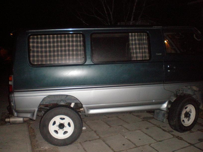

Is this your rig - (if so -nice!)
If so, your right, 215's would look small on it. Mystery Machine (Bruce) would be the one to advise you, though 32"s look good.

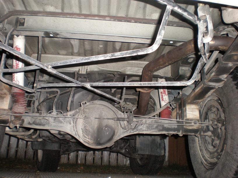

Here is a bad picture of the van, its starting to snow. Then one of the suspension from the back.
- suspension.jpg (106.9 KiB) Viewed 7197 times
- delica.jpg (73.78 KiB) Viewed 7191 times

how much did it cost you to do that lift? did you buy it as one kit or bought everything seporatly
