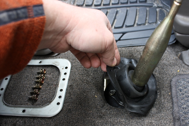

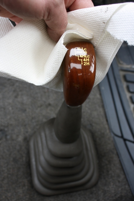

Remove the shifter knob… it just unscrews from the top of the shifter lever.

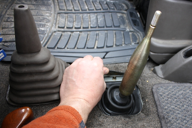

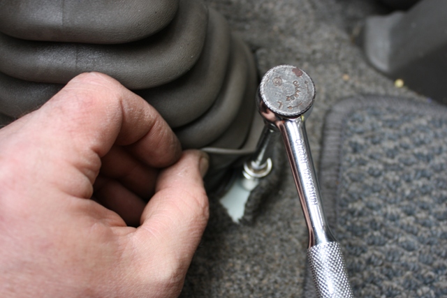

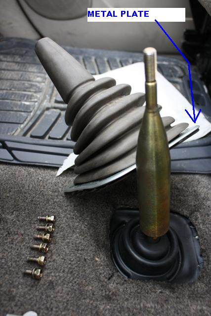

Under the carpet, there is a metal plate with 6 bolts (10mm) which will need to be removed. In my picture, I had left the grey shifter boot off from the field repair. Normally, the bottom of the boot would be fitted under the metal plate. Remove the metal plate and the shifter boot.

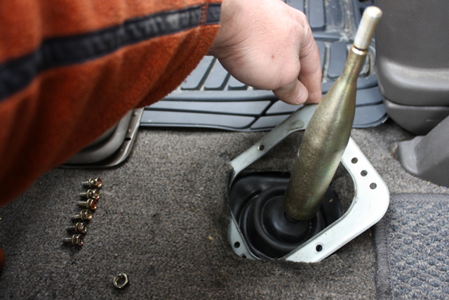

There is a second black rubber boot that seals the hole in the floor of the van. Pull this back out of the way. It stays on the shifter assembly. This will reveal the top of the transfer case.

To remove the shifter assembly from the transfer case, you will need to remove the 4 bolts (12mm) on the larger of the 2 plates. DO NOT remove the 3 nuts on the top triangular-ish shaped plate as these 3 bolts could fall inside the transfer case if they happen to be loose.

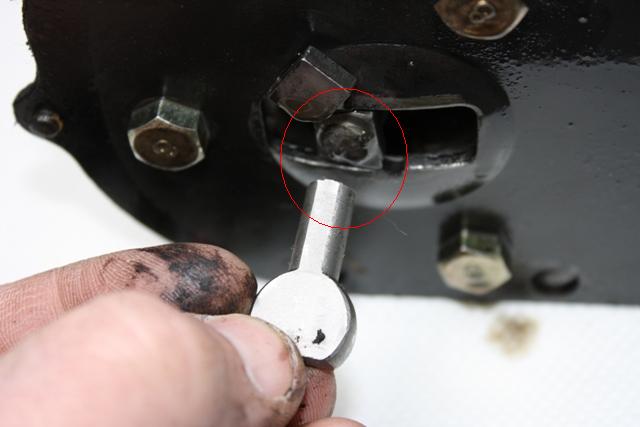

This picture shows my problem… the lower tab had broken off of the stick inside the transfer case. The break appeared as though it had been cracked for some time and I assume it must’ve bent when I shifted into 4WD the final time and caused it to jam and subsequently break.

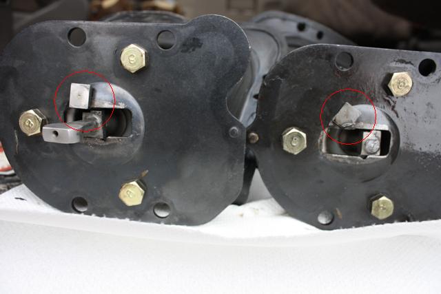

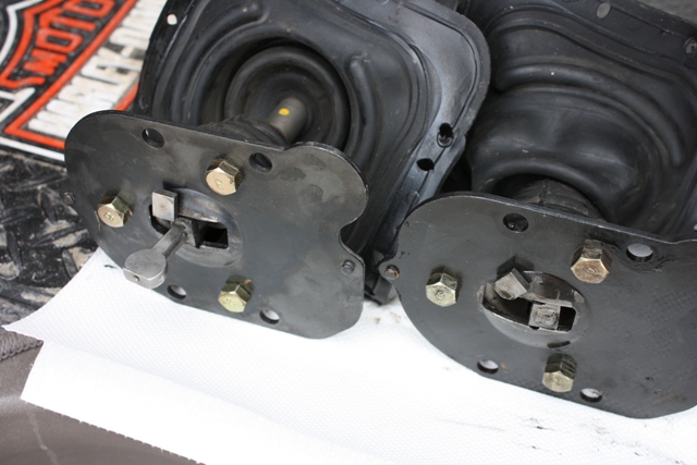

Comparing my new shifter (thanks to CCAuto) with the broken one reveals a significant difference in the manufacture of the large shifter plate. The tab welded to the bottom of the plate on the broken shifter was welded at an angle whereas the tab on the replacement shifter is square to the slot in the plate. The corner of the tab on the old one had actually been worn off over time. I am unsure if this would have ultimately caused issues but the difference is suspect to me.

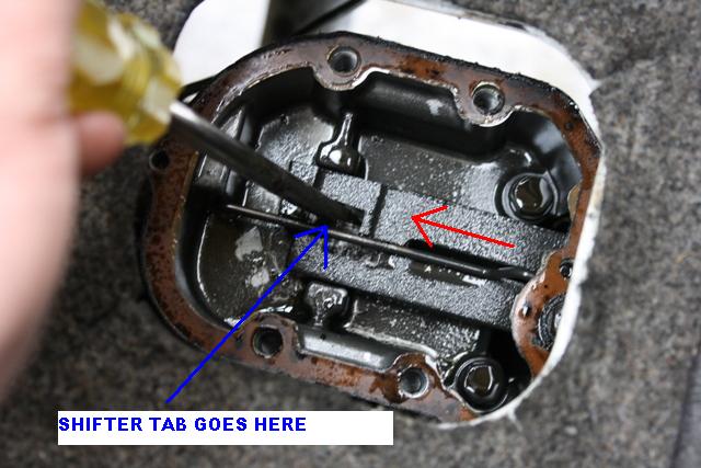

After installing your new shifter with the round tab in the spot where the screwdriver is located in the picture above, reinstall the four 12mm bolts and tighten them. Make sure the black rubber boot sits on top of the floorboard but under the carpet. Put the metal plate over the outer boot so the bottom portion of the boot is under the plate.
