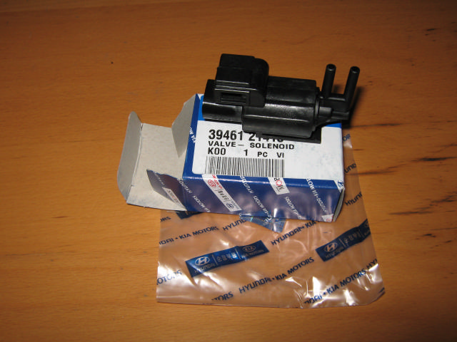

Re: 1992 Delica: Cuts Out then Restarts Immediately?
You may need to replace fuel return valve solenoid.
We have it in stock_new.
Steven
Steven
