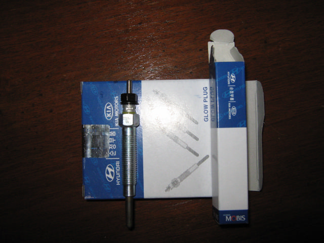

Hey guys.
I just swapped out my glowplugs. For the start of the cold months. And when I went to start it up I had to wait a really long time for the second click like 10-15 seconds. After that it clicks over really rapidly about 5 times then stops.
This morning it started then died immediately and when I tried to restart it the relay just clicked on and off. Eventually I just had to give it a hard start.
I think I must have done something wrong when I put the bus bar on or something.
I reconnected the 2 wires to the number 3 glowplug where they were before.
But I am wondering about the temp sensor? Where is is exactly.

They are hyundai. From cvi. Those guys know these vans pretty well.

If you have a working Super Quick Glow Plugs Control System, Hyundai 11V glow plugs are not working for your van.maxpowers wrote:They are hyundai. From cvi. Those guys know these vans pretty well.
Here are quick answer for 11V Hyundai glow plug application.
1. In the early model ( before Aug 1993 ) delica L300 and Pajero with perfect working control system with 6.2V , 11V Hyundai glow plugs basically do not work.
2. If you have a manual control system in your 6.2V system due to whatever reasons , 11V Hyundai ones work.
3. Hyundai 11V glow plugs work excellent for all 4M40 engine and late model L300 and pajero ( 4D56 ).
If you have different system other than 6.2 V, you may have another problem.
Steven

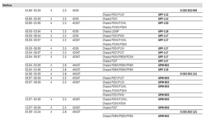

Bosch Makes glow plugs for the Delica (L300&L400) from the Bosch.au website:
See page 28 of 88:
http://www.bosch.com.au/content/languag ... _Ready.pdf
See page 28 of 88:

Looking at the Chassis number for which glow plugs work on which motors I do not think the Glow Plug interchangeability that people have been using is right.....Or why would Bosch have such a extensive list, when they could just make 2 different models???
I sent an email to Bosch to see if we can get this glow plugs in Canada even if one of the Delica Dealer needs to stock them for us...

@ RSI interesting. does hyundai not make a 6.2 volt GP?
I never even looked at the box I just swapped them CVI has never led me astray but mistakes happen maybe they tossed me the wrong box. I will check the box tomorrow, not at home right now.
session the gnar
- Rising Sun Auto Import
- Posts: 1366
Re: Another glow plug thread!
Hyundai has only 11V 'Self Regulating Glow Plug System' in their small diesels since mid 1990's.maxpowers wrote:@ RSI interesting. does hyundai not make a 6.2 volt GP?
So there's no 6.2 V glow plugs in Hyundai Motors.
Mitsubishi threw away 6.2V 'Super Quick Glow Plugs Control System' in 1993.
Steven

1) look in the back of the Bosch PDF manual linked above it has all the specs for the glow plugs...threads, volts, dimensions -very handy stuff
2) Bosch plugs retail $11-40.00 so if we can get Bosch to sell them to a distributor we may have a good source for good plugs (OEM in VW / Volvo diesels).

Bosch makes glow plug for Delica but not 6.2 volt. Only HKT, NGK and Mitsubishi Gen makes 6.2 volt as per my knowledge.

On the list they have 6.2volt ones listed this is a 2010 catalogue...full specs are in the back of the book.
GPF-133 6.2Volts (full specs page 54 for the part numbers listed)
The catalogue is from Australia. Maxoverdrive as a dealer do you have access to Bosch can you check if available if you do?
