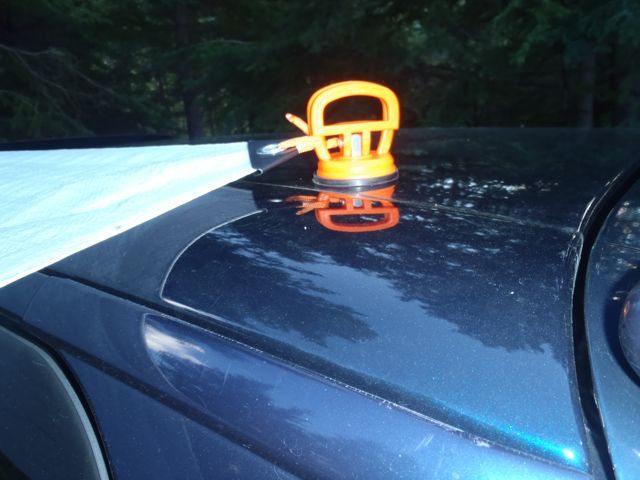

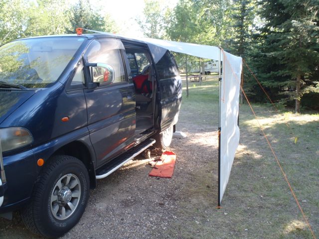

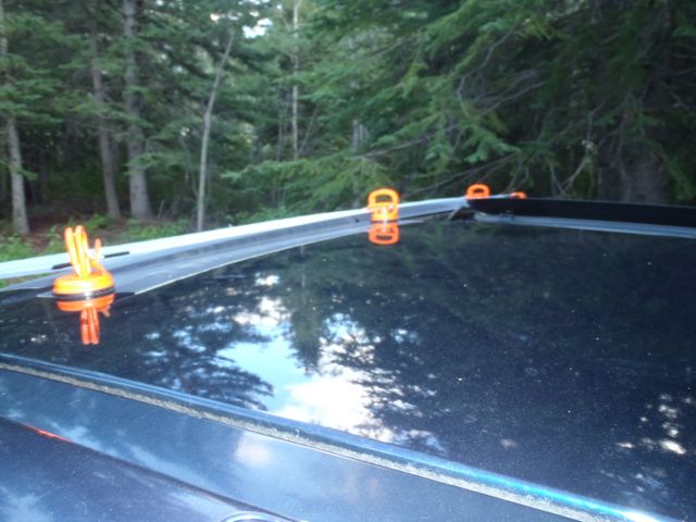

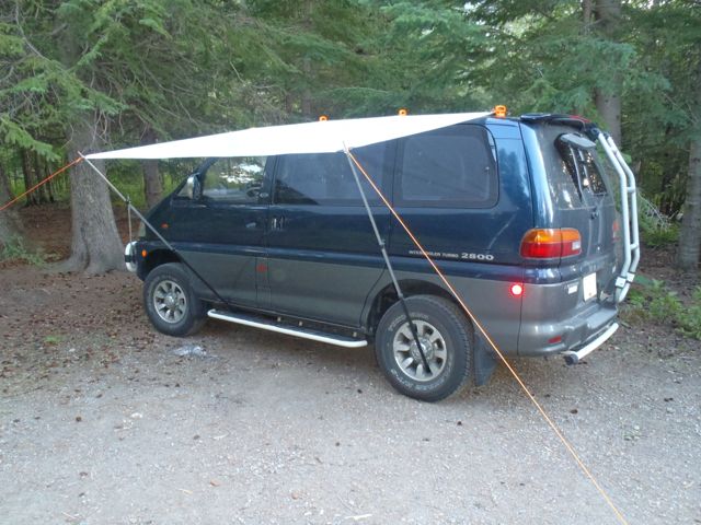

I finally got around to posting this , Needed an awning for a road trip this summer , this was a cheap solution that held up to rain and wind storms.
Those are 2 inch auto body suction cups from princess auto , extending tent poles from Surplus Herby's a few tent pegs and some line total about $30 worth of stuff. The poles could be either angled out from the van or placed vertical.
