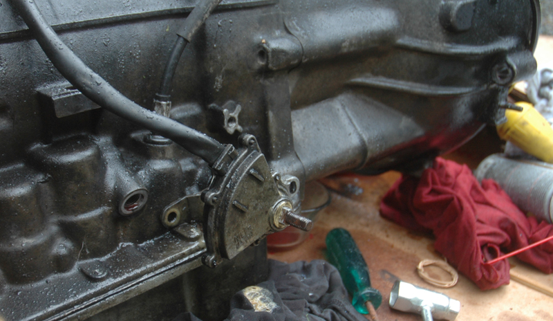

Photos from this link to the 'the good part' is just that.
I am trying to free it (soak in wd40, a mix of atf/acetone and fluid film) with light prying action and tapping on the bolt to get things vibrating off.

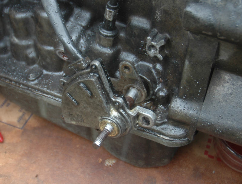

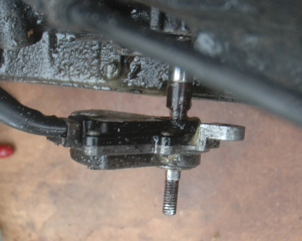

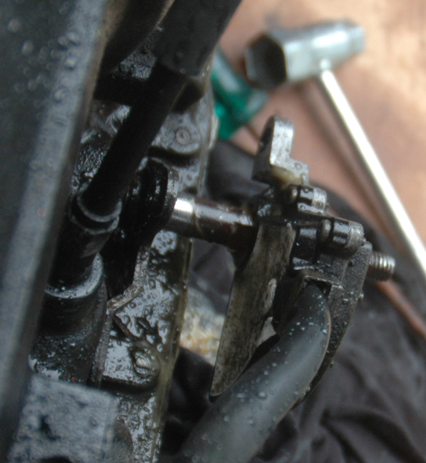

Post by rainypotato »
pics
the neutral safety switch, seized beyond belief and rather brittle
BeV
BeV
yup, I pounded that rod from the other side...oops?
view to the bell housing
