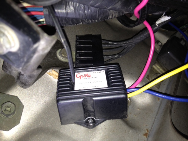

My van (from cc auto) has the drl unit under the hood between the fuse panel and the drivers side headlight.
My old van had headlight issues like that when the drl unit burnt out, it melted to the consistency of a soft marshmallow. It was a black cube about 35mm square.
I replaced it with a heavy duty version and all was good.
I think CC autoes has a pic of the heavy duty one their parts page, it has a ribbed metal case.
Here's a pic of the one in my new van

There isnt a drl module that i can see. Any chance its wiring directly to my ignition switch amd something is messed up there? any wiring gurus out there? Ill have to pull the hradlight relay during the day till i figure this out!Artacoma wrote:My van (from cc auto) has the drl unit under the hood between the fuse panel and the drivers side headlight.

Fixed thanks to claude. It was a relay put in aftermarket hanging upside down under the fuse box full of water. Ill get a replacement and move the relay to a better location. Woo hoo

Thanks to this thread I was able to trace and resolve the same problem. My DRL relay was mounted under the hood and got wet during a heavy rainfall causing the headlights to stay on. Simple fix really, just disconnected the relay, pried the cover off, let it sit in the sun for an hour to dry, put it back together and voila headlights go off and on as they should. I also strapped the relay out of the way so it wouldn't get wet again. Thanks everyone!
