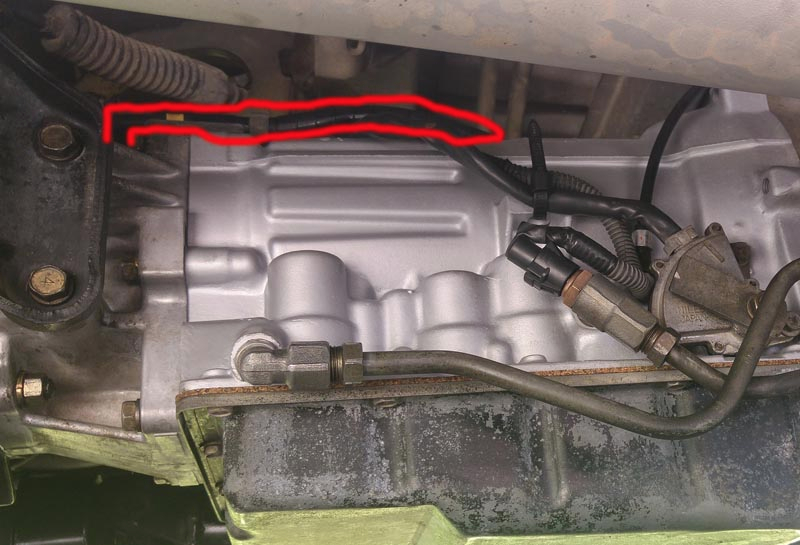

My transmission has a breather, it runs from the top of the rear housing forward along the top of the transmission. It's a rubber hose wrapped in a protective plastic coil, and ends in... a thing I haven't looked too closely at. Some kind of valve, I think. Shouldn't be too hard to extend the rubber hose. You can see it without dropping the transmission.

OK, I had a good look at that hose, it connects to the transmission at both ends. I'm guessing it vents into the bell-housing which seems pretty well sealed other than the inspection plate. I think trapped air in the housing would provide the required protection, but a bit of silicon for the inspection plate could be added easily.
Can anyone confirm?
