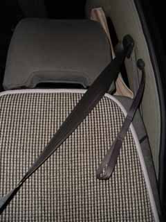

AmI missing something?? I can see no easy way to prop the passneger seat up, without wedging an object( a 2' level in my shop). There surely is some way of propping it up that I am not seeing.

Look next to where the passenger seatbelt hangs on the 'B' pillar - there should be a small strap that hooks around a metal catch/hook on the base of the seat when it is tipped back.
If you can't find it, let me know and I'll get a photo to show you....

Here's photo:
Hood strap.jpg (35.33 KiB) Viewed 5711 times
Where it attaches on the hood when it is raised should be pretty obvious, it looks like a cleat. Note that you can hook at the end of the strap, or raise the hood even higher and hook part way up the strap. Depends on space needed.
Another weird stumble you may have is if the seat is too upright it hits the ceiling and the hood doesn't open much.

Also, if you have the Captain's chairs in the rear, make sure the one behind the passenger seat is facing forward and pushed back, otherwise it interferes with the 'hood' as well (read: the chair on top of the 'hood').
