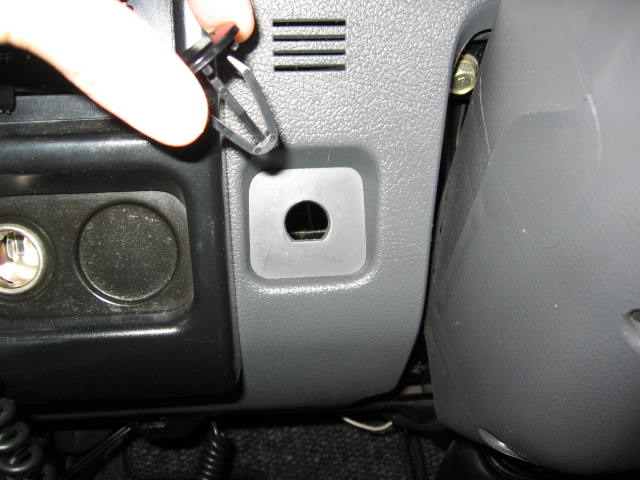

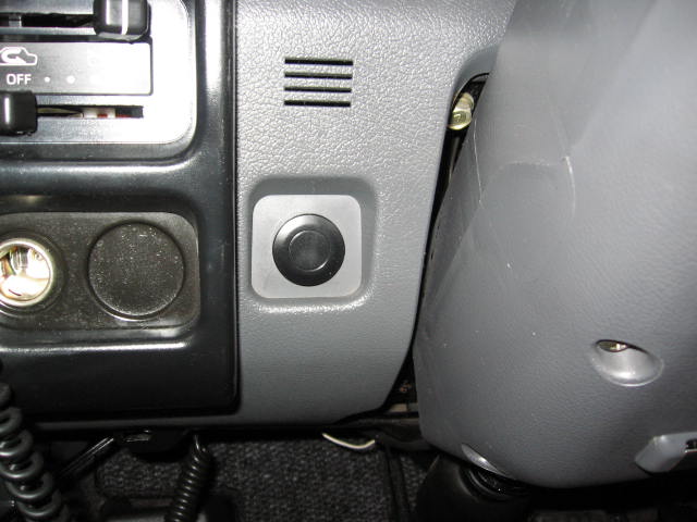

First was the lack of throttle adjuster. Here are the pictures once again:
Mystery Machine brought up the whole 1994 model possibility:
Mystery Machine wrote:Aha!
In June 1993 they released the '94 model year L300. I guess once a new year has started (i.e. Jan 1993) they can't call any following improved/updated models a '93 model year because of any 'non' updated ones sold before them, so they make it sound like you are getting next years model a bit earlier?? (I hope that makes some sense??)
There was very (VERY) little changed on the L300's between 1990 and 1993 except for some minor trim changes and things like seatbelts going to 3point.
In June 1993 when they launched the '94 model year L300 there were some significant mechanical changes.
Water cooled turbo
Totally revised glow plug circuit (uber quick)
Different cam belt (which makes me think there are other changes 'inside' the engine)
No hand throttle (I miss this!)
Different set-up on throttle/fuel pump (same basic pump)
I am sure there are more changes/differences too - I am gradually finding more out as I work on the car!
In answer to Jesse's comment - the new Mud Monkey doesn't have a hand throttle and I can confirm that any June 1993> L300's won't have either (except cars built before and registered after June 1993)

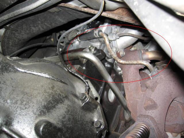

So I dropped by Jesse's and looked under Marshmellow, and there definitely seems to be a pipe on the Jammy Dodger that is not on his '93 Super Exceed. Sorry about the angle, but here is a picture:
Is this the pipe for a water cooled turbo?
If that's the case, then it perhaps the Jammy Dodger is a '93 built '94 model.
Can anyone confirm?

BINGO!!
You've got yourself a water cooled turbo there....no doubt about that one! This confirms that your motor is a '94 model year (manufacture of these started in June 1993)

Took a peek under mine when you left. No water pipe like yours has.
You've got the water-cooled turbo.
LUCKY ! :-D :M
