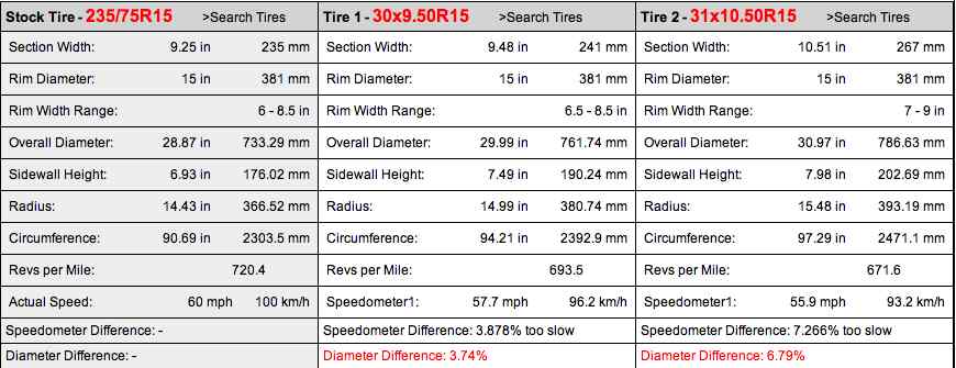

You're best bet for the standard 6" rims would probably be 235/75r15 as the 30" seems to require 6 1/2" rims. I've attached a table that will give you an idea of tire size vs. rims width and speedo changes.
I agree with 39Ronin, Costco has pretty good price but I've had even better luck with Mardy for price. Just give him a call with your tire choice and compare with the Costco and the likes.

Thanks for that handy chart, Delicat. I totally missed the rim width part of it at first. I don't think I can convince the wife that we need new rims for our Delica just yet, so the bigger tires are going to have to wait. I'll work with Costco and Mardy for some tire pricing tomorrow.
