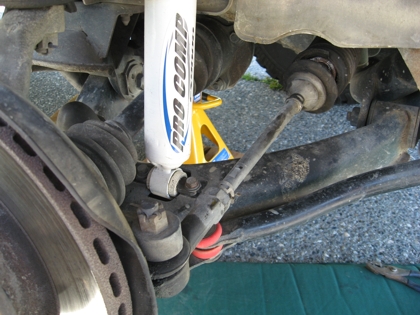

Shake the tire while on the ground or in the air if it moves in and out just a little ,its prob your tie rods ,I know this only because ive just replaced mine on the drivers side and its all good and solid now.Give that a try,it should feel like something is loose when you move the tire side to side. check the boots also see if there in ruff shape ,split cracked or in half any ways 100$per side 18$ for the boot.Its a fairly doityourselfer job just get realignment when done.
