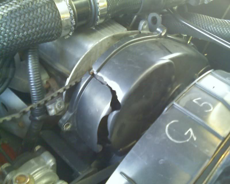

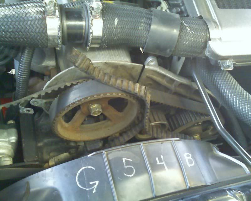

Re: Timing Belt maintenance
balance shaft belt failed and got caught in the timing belt
Replace those belts/pulley's people !
