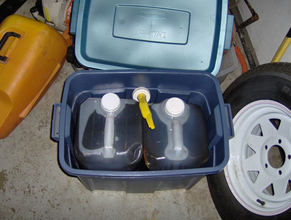

I'm scared of those delicate little cubes for transporting WVO and found that two of them fight perfectly in a Rubbermaid rough-tote. The lid fits on nicely and they can be stacked. I just shudder at the thought of a full cube of goo pouring out of a ruptured cube
- wvo rough-tote.jpg (196.33 KiB) Viewed 6544 times
