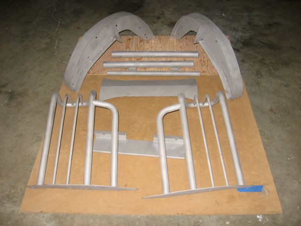

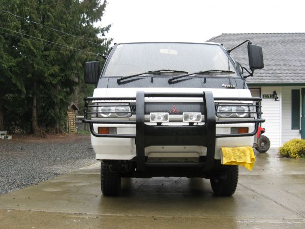

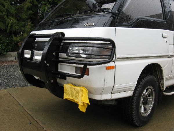

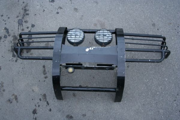

Finished the bush bar awhile back, just finally getting around to posting some pics here.
Wanted a wrap around bumper and finally found one on the forums here.
I initially thought it was chrome painted black. The paint was hardly sticking and scraped off with a fingernail.
After researching chrome removal I decided to get it sandblasted, hoping to scuff the chrome up enough to primer.
Stripped the bumper down to pieces and took it to a local sandblaster.
The guys at the sandblasting shop figured it was made of stainless steel. a magnet confirmed their suspicions.
This made the sandblasting and painting a whole lot easier. Picked the pieces up the next day.
Primed and painted with Plasticote spray paint from lordco. 2 coats black primer, 3 coats chasis and rollbar black.
The PIAA lights are off my old bumper. The housings were corroded so I wirewheeled and repainted them too.
Heres some pics, cheers, colby

Re: Bush Bar Facelift
Nice job!
One question though, how do you change the light bulbs of the headlights?
- Posts: 84
- Joined: Sun Jul 05, 2009 8:48 pm
- Vehicle: 92 Exceed
- Location: Vancouver Island
There are 4 stainless steel allen head bolts on either side to remove it.
takes less than a minute. as long as you have the right allen key.
