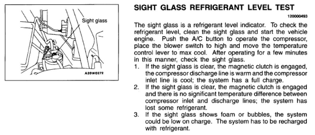

There are several pages on troubleshooting in the shop manual. The fuse is the first thing to check. Here is a basic check for refreigerant level if you can get the compressor to work.
site glass.JPG (101.66 KiB) Viewed 7884 times
