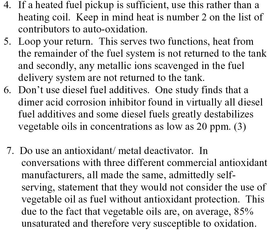

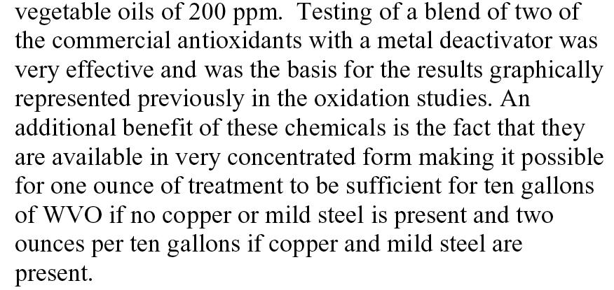

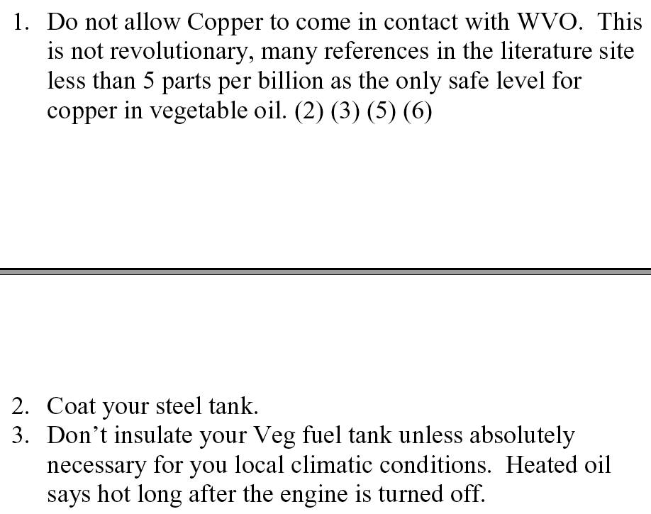

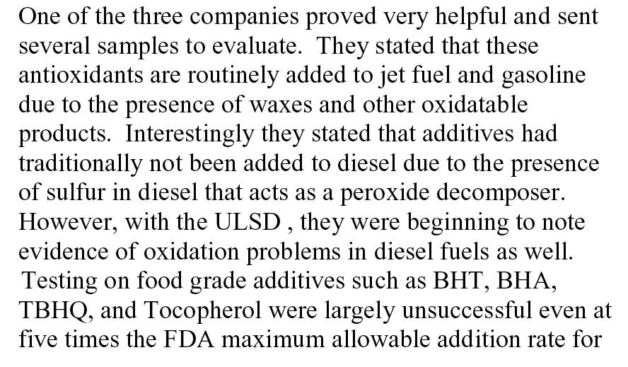

Thanks friend,
Not that I always jump to the conclusion but... here's what they had to say. Interesting.
wvo 1.jpg (74.89 KiB) Viewed 2841 times
wvo 2.jpg (160.87 KiB) Viewed 2832 times
wvo 3.jpg (105.75 KiB) Viewed 2886 times
wvo 4.jpg (90.87 KiB) Viewed 2831 times

BCDelica wrote:Good article Ari, really goes to show that heat WVO tanks are quite unnecessary. As interesting how there recommendations are to loop the return, heck it's easier.
Wonder about the slight anti oxidizing affect of (pure) acetone I read about many moons ago?
the loop return is easier, but requires more diesel fuel for purging...
