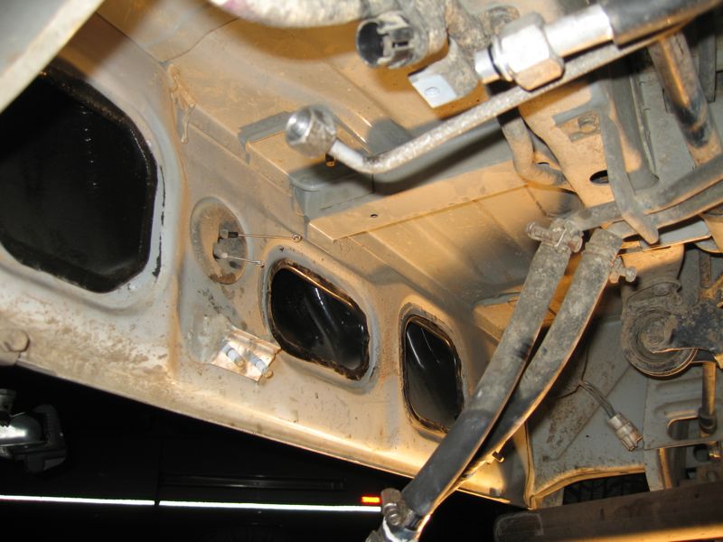

Not sure how your camper Delica looks underneath, but if you have the rear AC and heater at the same place as a regular l300 this might be a good area for a tank. I took it out last week and it opened up a quite large space. Also routing the lines would be easy due the vent openings.FredVenne wrote:Next thing is to get a propane tank setup outside the van... any ideas?

Thats a great spot for a tank!
How long did it take to remove the rear heater core?
Just curious but do you loose some cooling effeciency when you remove the rear core or does the coolant only circulate back there when the controls are on hot?

Not very long at all, you only need to make sure a AC shop took the pressure off your system and also you need a hose and fittings to loop the coolant.
I don't think I'll loose much cooling effect as the heater core is tiny. You can see a few photos of the heater/AC assemply on my website: http://dinoevo.de/gallery/photos/recent-photos/
The core is hot all the time and the rear heater switches just regulate the airflow and not the coolant. In the end I'm going to put my Diesel heater and coolant hot water tank there which fit nicely.
