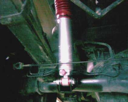

I got my 9000s installed at NSOR. Most shocks have a loop end attachment, the Delica has a pin end for the rear shocks. I had the pin end ground off and welded a new bracket onto the axle. Now my Delica takes a loop end shock in the rear :? . The new brackets cost me $80 extra to install and remove the other ones.

Personally I prefer the higher quality of Rancho, but that's just me... smiles. There was no hassle. I went out for a coffee and read the Globe & Mail, came back and it looked just the way I described it should look like, just how I wanted it.

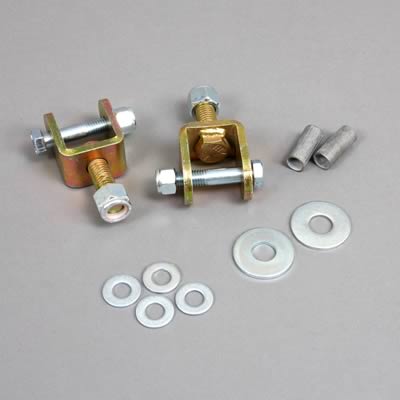

The 3rd option, which is the easiest, is to buy the pin to eye adaptor $40-50, drill out the existing pin hole on the bottom shock mount (stock it too small), insert adaptor, gun on the stover nut, and then measure (at full articulation) from the center of the eye (bottom) to the center of the eye (top). This will your stroke length. Then measure (at minimum articulation) the same. This will be your compression length. Take those two numbers and look for the right shock. Being eye to eye, you will have many options.
No welding, straight forward install. From my memory, going this route, you will need a 17.5" stroke length shock.
This is the adaptor you need :
http://www.summitracing.com/parts/EXP-690001/
Procomp part # 690001 $25-40 depending on where you buy it. Comes in a pair with hardware.
