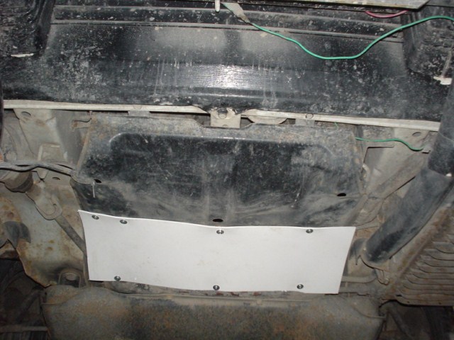

I am thinking ahead too, I remember getting the area in front of the rad filled with snow so I took some left over puckboard and made a snow guard. Should help keep the wind out for the winter too.

- No more snow in there ...

While a good idea to keep the snow out, it'll also keep the air out, and you need that to cool the radiator. I'd keep an eye on your engine temps...

Will the temps really rise that much given the winter temperatures here?
We are pretty much -10C to -30 for the next 4 months.
Isn't it the same as putting cardboard in front of the rad for the winter
which most do here in Saskatchewinter...

Why not add something like Falco's "Gopher Grille"? You could even have the spaces (openings, whatever you want to call them) made quite a bit smaller. It would prevent large amounts of snow from getting in and still give you air flow. And if they did get plugged, i'm sure some air will still make it through. Just a thought.

Air temp is not quite as important as air flow, and you've effectively blocked it all off.Firesong wrote:Will the temps really rise that much given the winter temperatures here?

I went with the suggestion and cut 4 holes in the cruncher.
roughly 1.5" x 3.5"
Should still do both jobs effectively.
