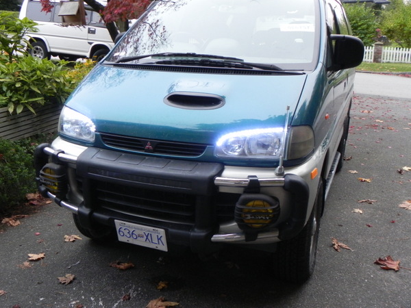

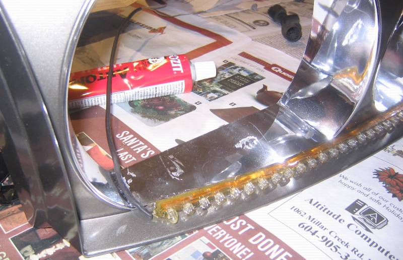

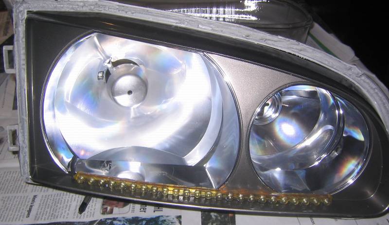

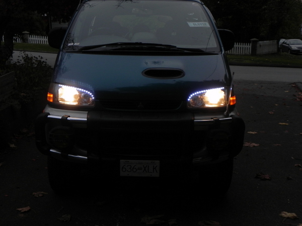

Having surfed through the forums and getting ideas for my Daytime Running Lights, I chose to use some ideas based on Jesse's work. I got some LEDs off ebay for $5 and glued them into my headlights when I was changing the lenses. I ran a power line off the accessory in the cabin by the fuse block and out along the shifter cable, through a 10A inline fuse and then to my power side of my LEDs and then grounded to the frame.
Lens cooked off at 250f for 20-30 min
Frame removed and LEDs glued

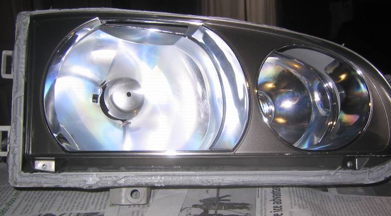

Headlight with frame off

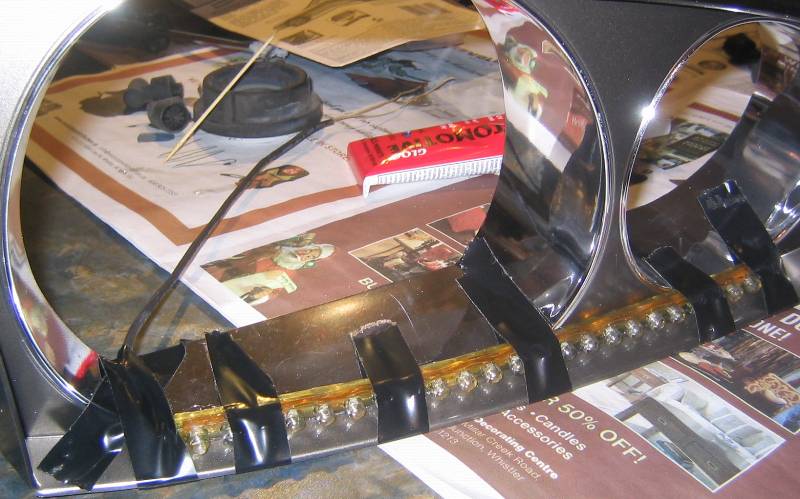

LEDs glued ready to remount
Ready to cook the lenses back on.  The wires run behind the lamp focus and out the weather seal.
Photo from about 100 ft away in the rain.

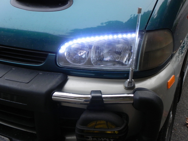

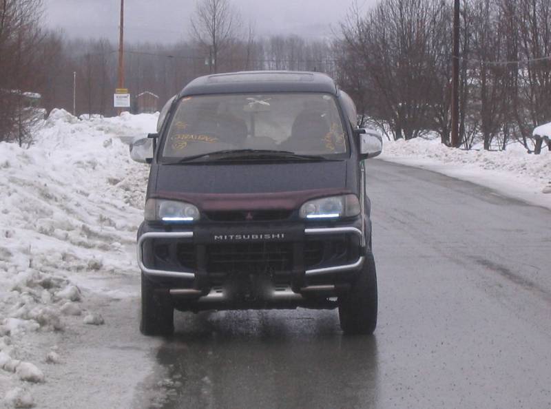

This is a fantastic mod for anyone installing DRLs - especially now that so many cheap LED options are available now. And they hardly draw any current. My kids call it the angry Jasper. Here are my results:

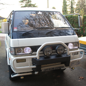

I'm addicted.

Anyhow, the LEDs in the original post no longer work. Not sure if they were just of cheap quality, or the heat from the other lights damaged them, but just keep this in mind if you are thinking of doing the same setup. If they burn out, they are difficult to change. Might be better to mount them somewhere not in the headlight.

If/when these burn out, I thought I would just abandon the ones inside the lights and mount new ones externally like others are doing. You could also just install a DRL module for that matter. That's the thing with most of the LED DRLs, no matter where you mount them - you generally have to replace the whole unit when there are any problems, not just a bulb.
